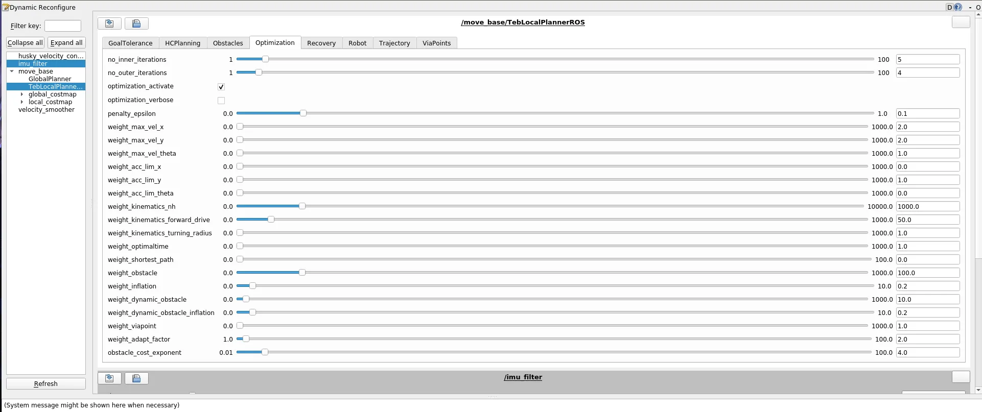

Quick Tuning
Quick tuning and configuration can be performed via rqt_reconfigure
rosrunrqt_reconfigurerqt_reconfigure

It is important to note that the DWA planner is no longer used and we use the TEB planner.
Configuration for the teb planner can be found in the TEB planner wiki. An excellent resource
for tuning your TEB planner is vailable in TEB planner tuning.
