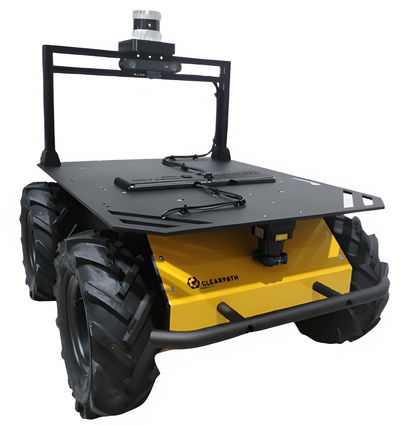

Husky PTB
_images/hh.png
This specifies the configuration for Husky PTB. It has an Phidgets IMU, Ouster & 2x Hokuyo lidar.

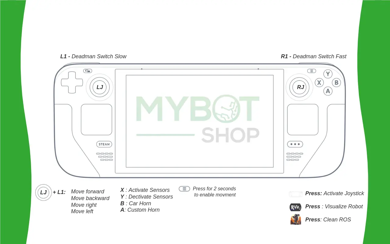

Steamdeck
_images/steamdeck.webp
Steamdeck - Basic Controls
  • Power button is on the top of the Steamdeck with the power symbol.
  • R2 for mouse left-click
  • L2 for mouse right-click
  • Left trackpad for mouse scrolling
  • Right trackpad for mouse movement
  • L2+R2 for middle mouse button click
  • - - - (The 3 dashes is located on the top right of the Steamdeck next to the Y button) Hold for 3 seconds to gamepadmode and hold for 2 seconds again to go to desktop mode.
  • Switching to desktop mode activates the cursor for the trackpad as well.
Steamdeck Activation
Important
When launching the Joylauncher, do not touch any of the buttons until the steamdeck displays the robot is connected or not connected.
  1. Ensure the Steamdeck is connected to the robot’s WiFi access point. Wait ~20 seconds after powering up.
  • This is automatically done!
  1. Ensure the robot is powered on and operational.
  2. Single tap the Joystick Launcher on the screen to activate the controller for the robot.
  • Do not open multiple instances of the joystick launchers, as this can cause zombie nodes to spawn.
  • Hold the - - - for 3 seconds until you sense vibration from the controller and then hold - - - for 3 seconds again. This is required to re-enable the mouse in the steamdeck.
  1. Ascento Homing Procedure
  • Ensure the Ascento is flat on the ground.
  • Perform Homing of the Ascento wheels L2+Right (required only at first boot or if the Ascento eyes blink red)
  • Once homed, press L2+Up to stand up the robot.
  1. Single tap the Rviz2 Launcher on the screen to visualize the robot.
Steamdeck - Termination
Single tap the ROS2 Clean to terminate all ROS2 instances only in the steamdeck (It does not effect the robot).
Steamdeck - Robot Controls
  1. L1 is the dead man’s switch for slow speed.
  2. R1 is the dead man’s switch for high speed.
  3. LJ (Left Joystick) is to move in x and y direction.
Loss of connection or (laggy connection) may lead to the robot moving and/or not stopping immediately. Caution should be taken when using the Steamdeck for the operation of the robot!
Steamdeck - Rviz2 Controls
  1. Right trackpad is used as a mouse
  2. Left trackpad can be moved up and down to zoom in and zoom out
  3. L2+R2 should be held when wanting to move the orbit in the xy plane.
  4. R2 should be held to orbit around the cursors origin

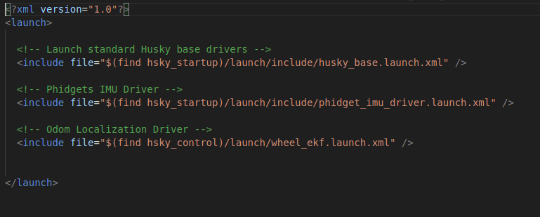

Adding ROS-Nodes & Launch Files to Robot Startup
  1. Navigate and open hsky_startup/launch/system_startup.launch.
_images/launch.png
  1. Include your custom ROS node or launch file. Please note that the image may differ, but the procedure remains the same.
Attention
An optional step is to launch the file to test if everything is working via: roslaunch hsky_startup system_startup.launch
  1. Run the following script:
rosrun hsky_startup startup_installer.py
  1. Verify if it is working correctly via:
sudo service hsky status
Important
After incorporating your custom node or launch files into the system_startup.launch, execute the command rosrun hsky_startup startup_installer.py to ensure the startup job on the Husky’s PC is updated; otherwise, it will not be applied.

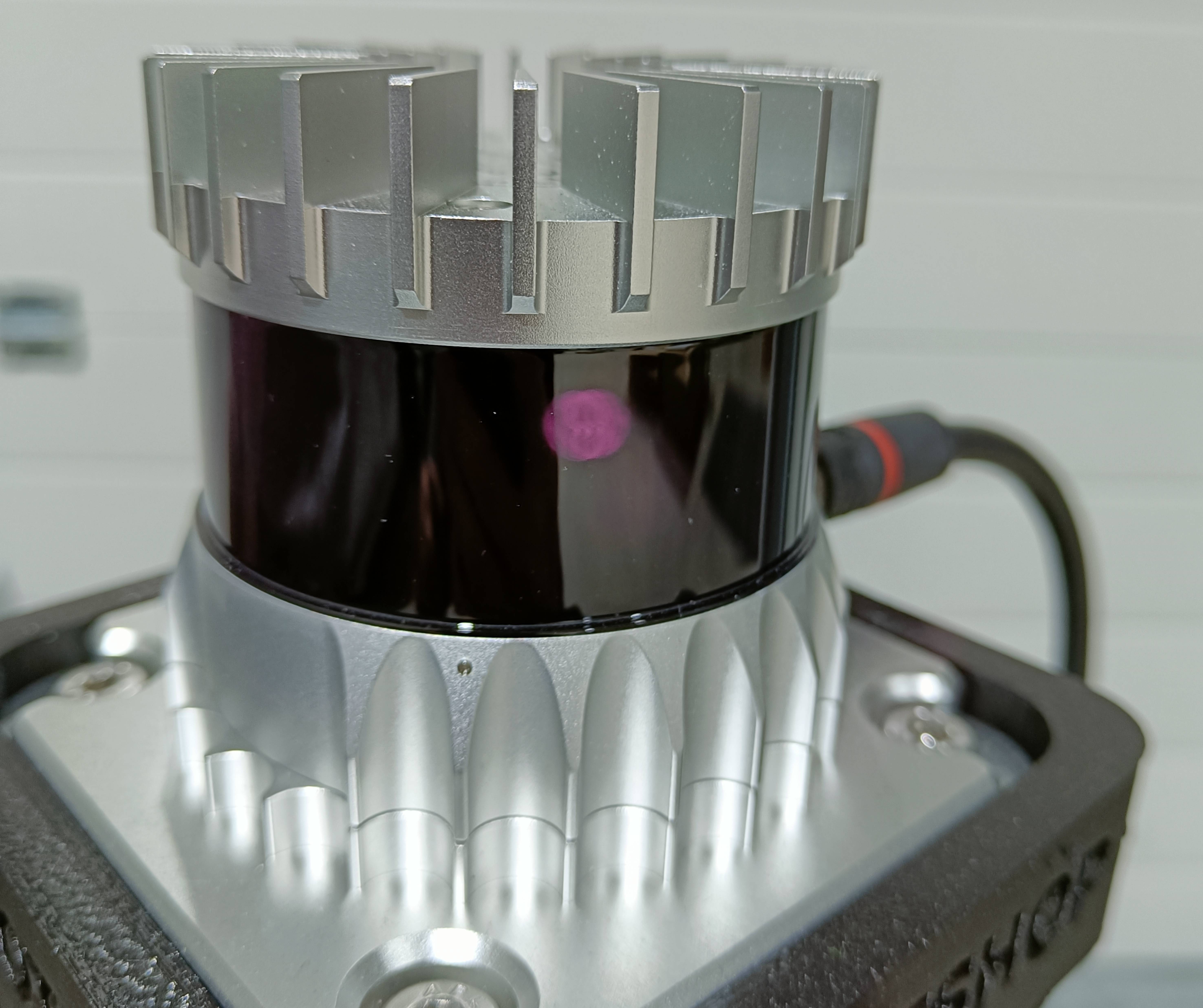

Ouster
_images/husky_mi_ouster.jpg
To manually launch the ouster driver, the following command can be used:
roslaunch hsky_lidar ouster.launch.xml
