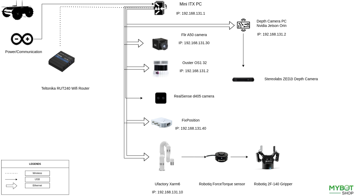

Connection Scheme
_images/hxg_schematics.png

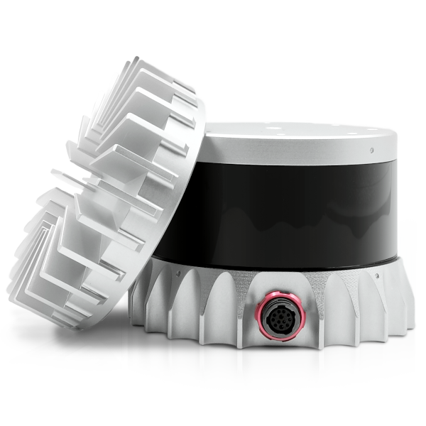

Ouster
_images/ouster.png
To manually launch the ouster driver, the following command can be used when using ROS(Noetic):
roslaunch hxg_lidars lidars.launch
To manually launch the ouster driver, the following command can be used when using ROS2(Foxy):
ros2 launch hxg_lidars system.launch.py

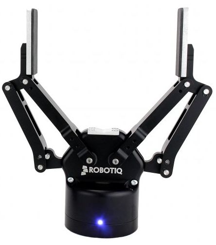

Robotiq 2F-240
_images/robotiq-2f-140mm.jpg
To manually launch the robotiq gripper driver, the following command can be used when using ROS(Noetic):
roslaunch hxg_robotiq robotiq_2f_140.launch
To manually launch the robotiq gripper driver, the following command can be used when using ROS2(Foxy):
ros2 run hxg_robotiq_2f_140 system_launch.py

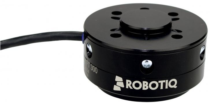

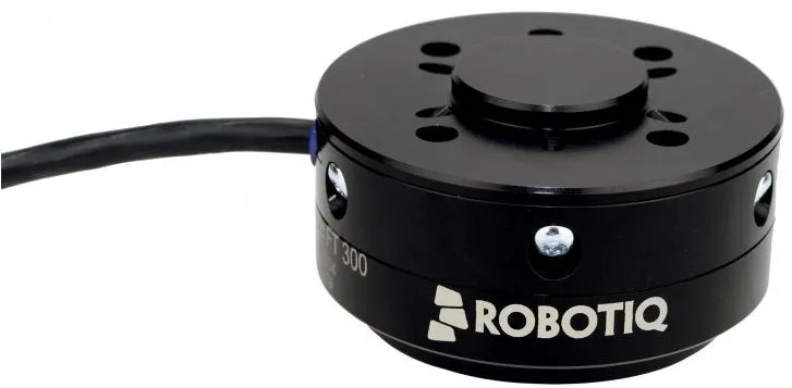

Robotiq Ft-300
_images/robotiq_ft_300.jpg
To manually launch the Robotiq Forcetorque driver, the following command can be used when using ROS(Noetic):
roslaunch hxg_robotiq robotiq_ft_300.launch
For force torque reset to zero ROS(Noetic).
rosservice call /robotiq_ft_sensor_acc "command_id: 8 command: ''"
To manually launch the Robotiq Forcetorque driver, the following command can be used when using ROS2(Foxy):
ros2 launch hxg_robotiq_ft_300 system.launch.py
For force torque reset to zero ROS2(Foxy).
ros2 service call /robotiq_ft_sensor_acc robotiq_ft_sensor/srv/Sensoraccessor command_id:\ 8

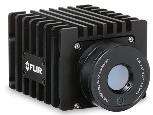

Flir
_images/flir.png
To manually launch the Flir driver, the following command can be used when using ROS(Noetic):
roslaunch hxg_flir system.launch
To manually launch the Flir driver, the following command can be used when using ROS2(Foxy):
ros2 launch hxg_flir system.launch.py

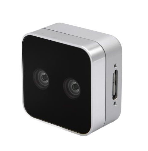

Realsense D405
_images/intel_rsd405.png
To manually launch the Realsense driver, the following command can be used when using ROS(Noetic):
roslaunch hxg_realsense_cameras wrist_camera.launch
To manually launch the Realsense driver, the following command can be used when using ROS2(Foxy):
ros2 launch hxg_realsense system.launch.py

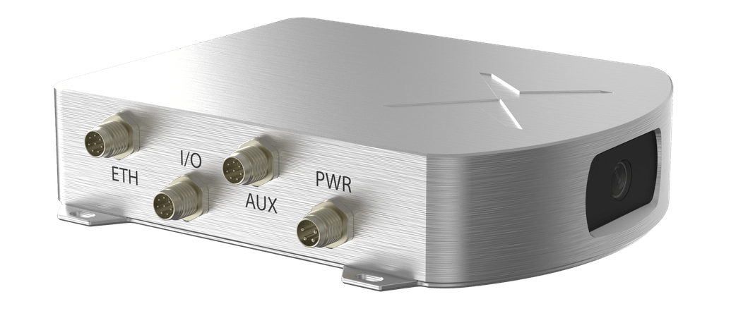

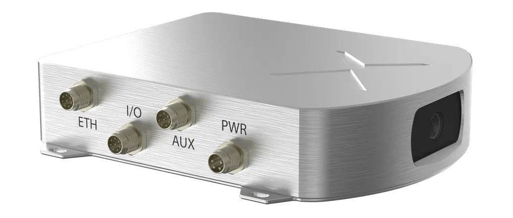

Fixposition
_images/fixposition.png
To manually launch the Fixposition driver, the following command can be used when using ROS(Noetic):
roslaunch hxg_fixposition system.launch
To manually launch the Fixposition driver, the following command can be used when using ROS2(Foxy):
ros2 launch hxg_fixposition system.launch.py

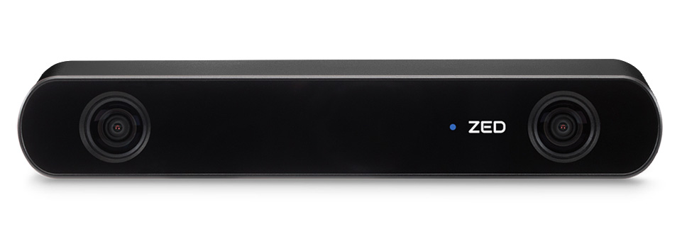

ZED2i
_images/zed2.jpg
On the robot start-up the ZED2i camera automatically starts and all its information is published to Husky’s main PC. The information can be verified via:
rostopic list
when using ROS2 you can verify the information via:
ros2topic list
It may take upto a minute for all the drivers of the Nvidia to start. The main purpose of the Nvidia is to enable the CUDA for ZED2. The stream for the ZED2 is transferred over to the main Husky PC via ROS Multi machine. An example stream can be viewed rostopic echo /zed2/zed2_node/rgb/image_rect_color.
Important
The ZED2i requires USB 3.0 port and in the installed Nvidia board there is one available USB 3.0 port. So incase of removal please plug in the ZED2i into the same initial port it was in.

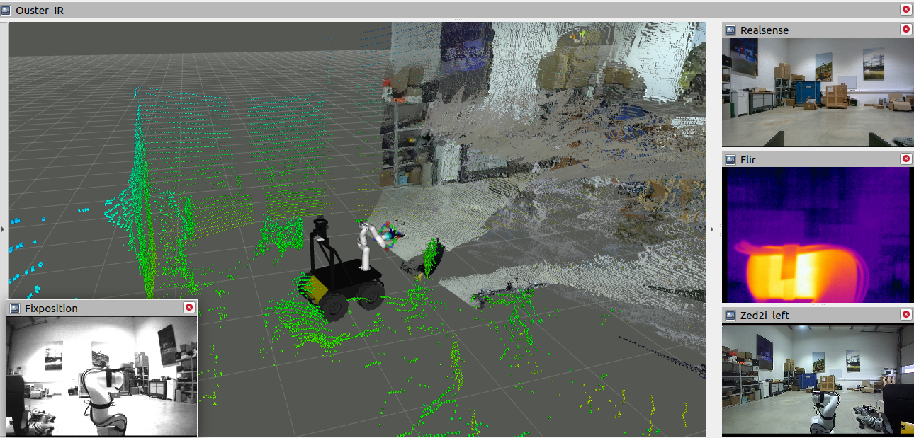

Visualization
_images/hxg_viz2.png
To visualize the robot in Rviz when using ROS-Noetic please run the following command:
roslaunch hxg_viz view_robot.launch
To visualize the robot in Rviz when using ROS2-Foxy please run the following command:
ros2 launch hxg_viz view_robot.launch.py
