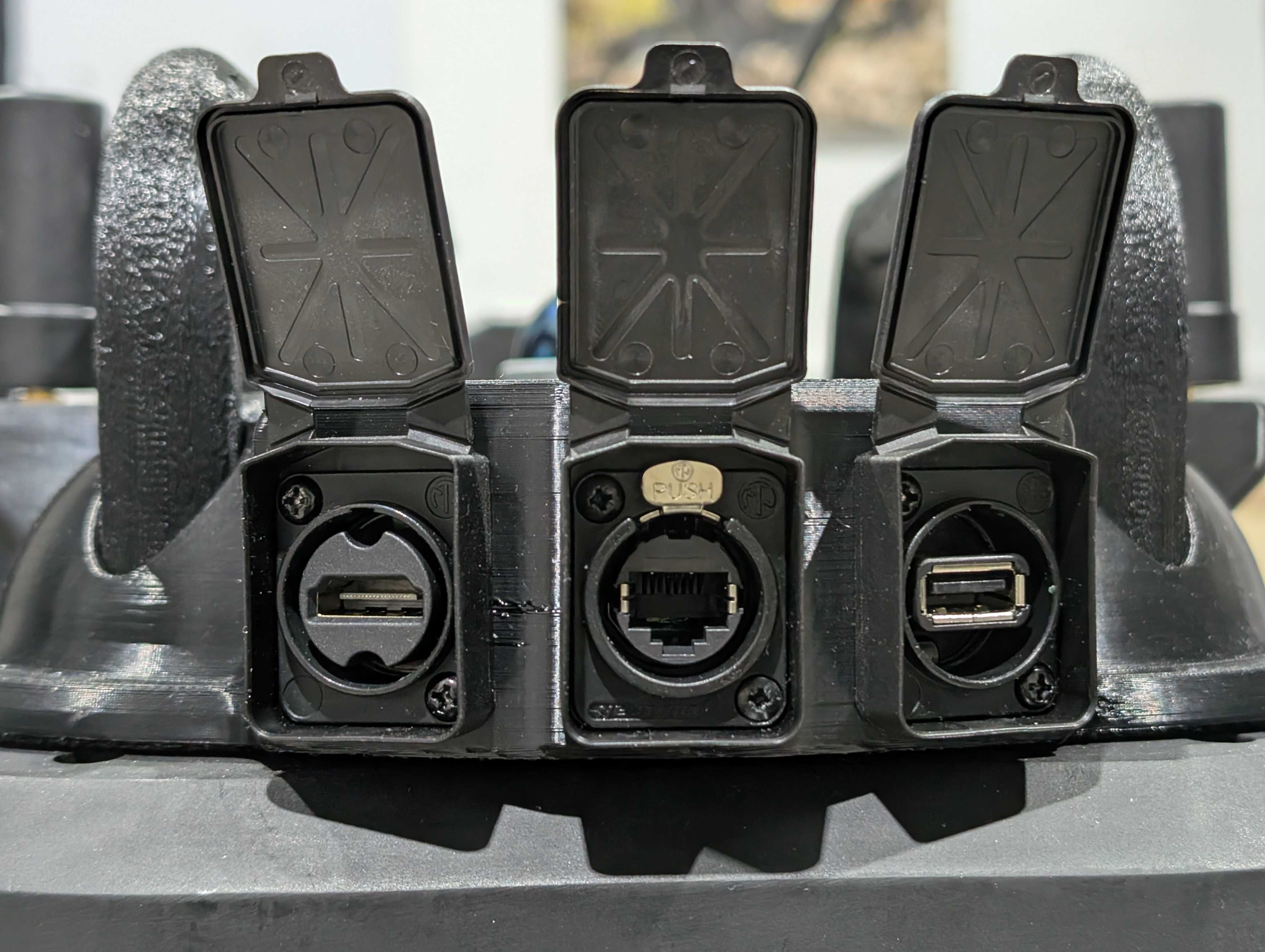

Connect via LAN Cable: Use a LAN cable to connect your PC directly to the robot. The LAN port is located on the back of the robot’s top cover.
The ethernet port can be used for setting up communication via LAN.

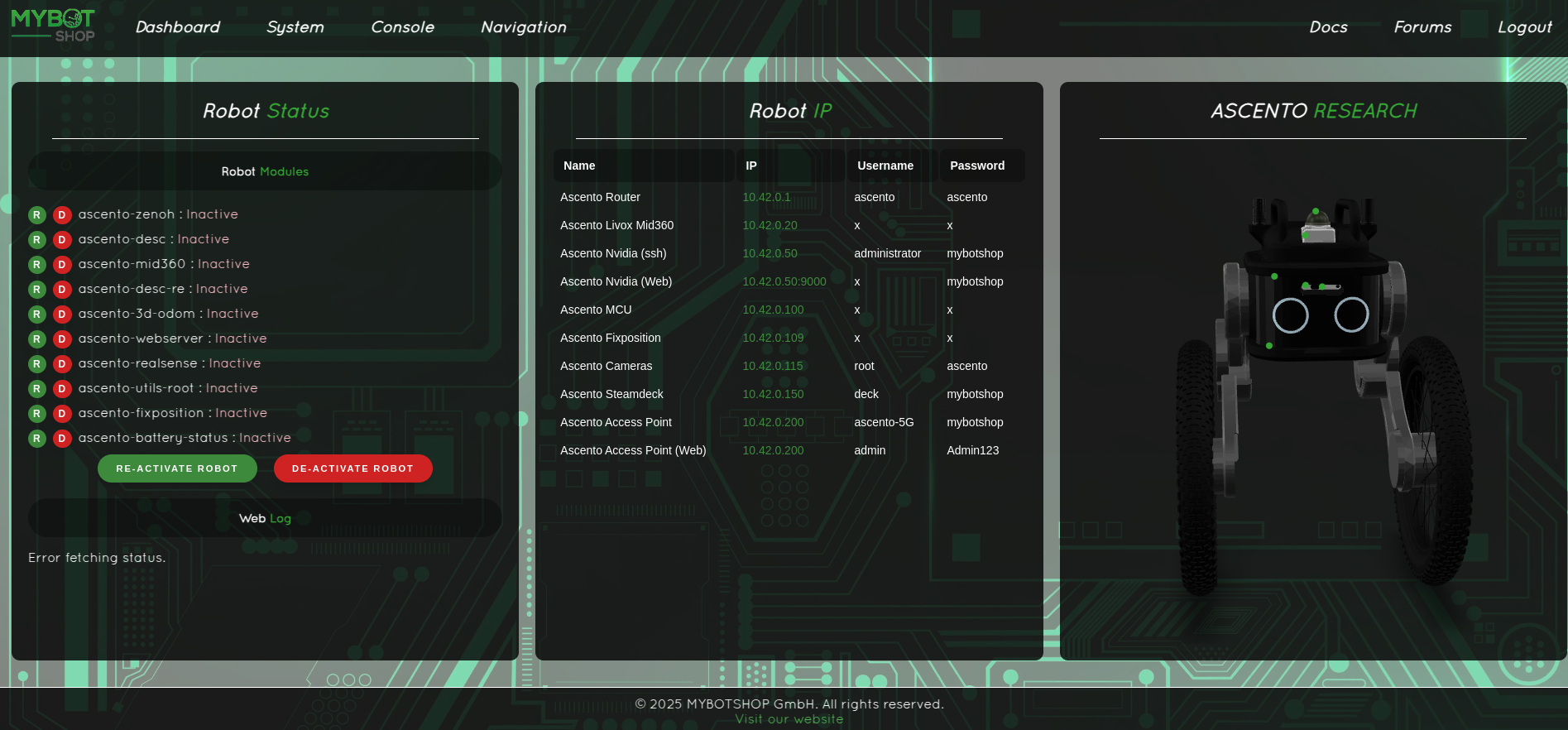

IP Addresses
The table below provides a reference for the IP addresses and login credentials for various Ascento components:

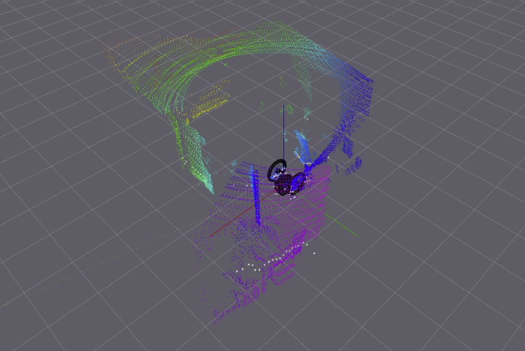

To visualize the robot in RViz:
ros2 launch ascento_viz view_robot.launch.py

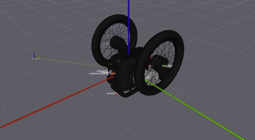

Ascento TF Tree
To view the TF tree with remapped topics:
ros2 run rqt_gui rqt_gui --ros-args --remap tf:=/ascento_0116/tf --ros-args --remap tf_static:=/ascento_0116/tf_static

Ascento Startup Services
Several essential Ascento drivers and services run in the background to ensure smooth operation. Below is a list of the main services:
Service Name |
Description |
ascento-description |
Launches robot state publisher for visualization |
ascento-zenoh |
Bridges robot MCU with the onboard Nvidia |
ascento-mid360 |
Activates the mid360 lidar |
ascento-3d-odom |
Activates 3D Odom and localization |
ascento-webserver |
Activate Robot webserver |
ascento-realsense |
Actuvates the Intelrealsense D435i Camera |
ascento-fixposition |
Activates fixposition GPS |
ascento-battery-status |
Displays rviz battery marker |
ascento-jointstate-publisher |
Launches joint state publisher for visualization |
You can query, start, stop, or restart these services using the following commands:
sudo service {service_name} status
sudo service {service_name} start
sudo service {service_name} stop
sudo service {service_name} restart

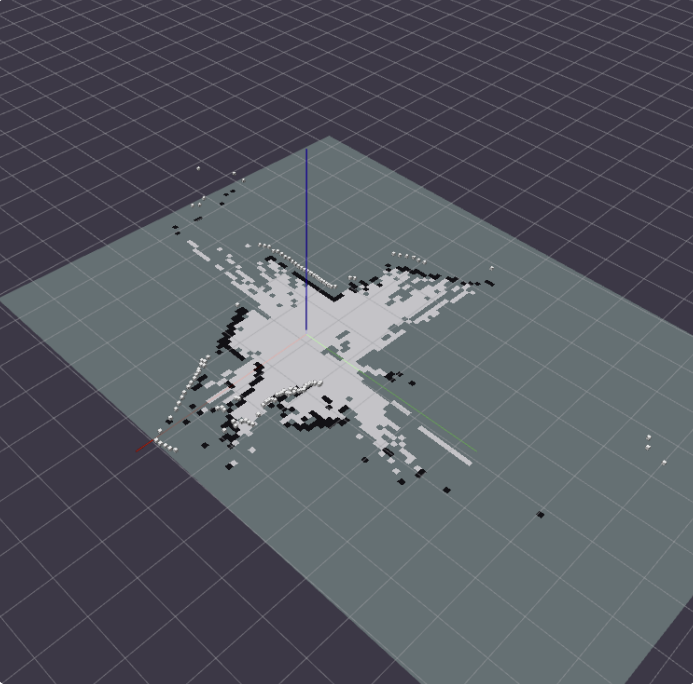

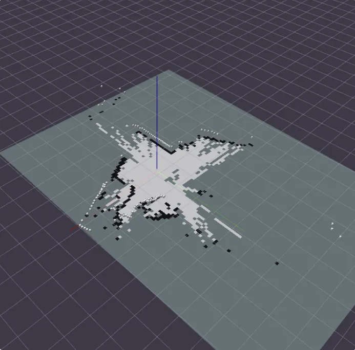

Ascento Simultaneous Localization and Mapping
SLAM allows the robot to perform simultaneous localization and mapping. Follow these steps to perform SLAM:
Ensure the ascento_bringup service is running.
Launch the SLAM process:
ros2 launch ascento_nav2 slam.launch.py
Begin mapping using the teleoperation keyboard at a speed of 0.2 m/s.
Exporting the Map:
Once satisfied with your map, export it using:
cd /opt/mybotshop/src/mybotshop/ascento_nav2/maps
ros2 run nav2_map_server map_saver_cli -f map_
Rebuild the Workspace:
If the map name is not map_, rebuild the workspace:
colcon build --symlink-install && source install/setup.bash
Finally, source the updated environment:
source /opt/mybotshop/install/setup.bash
Ensure all dependencies are properly installed and the environment is sourced before running these commands.

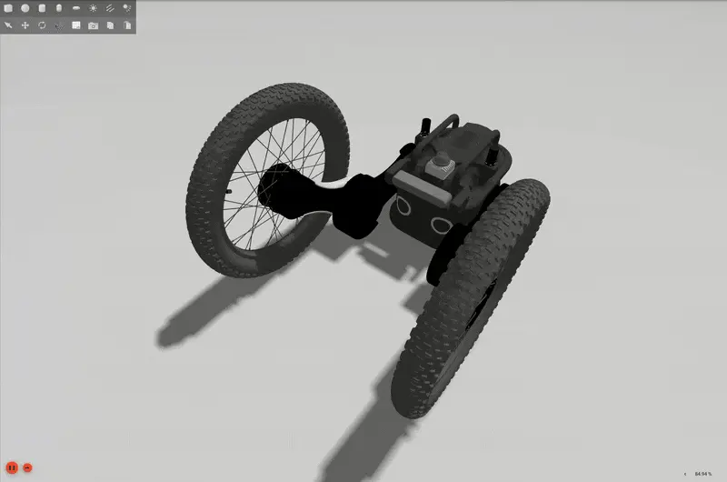

Ascento Simulation
To start the Ascento Fortress simulation:
ros2 launch ascento_gazebo fortress_simulation.launch.py

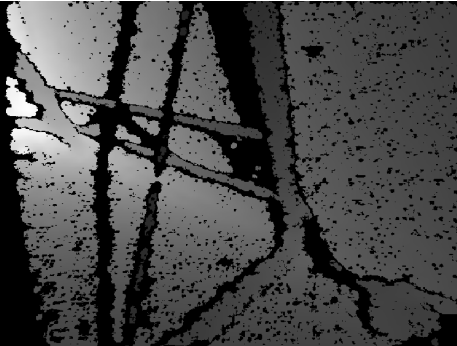

Ascento Intel RealSense D435i
![]() Color Image |
![]() Depth Image |
The D435i is launched by default through the Ascento bringup. Do not re-run the following command unless the ascento-realsense service has been stopped.
ros2 launch ascento_depth_camera realsense_d435i.launch.py
The launch file is pre-configured to enable continuous depth stream from the RealSense D435i without lag.

Ascento Mid360 LiDAR
The Mid360 LiDAR is launched by default through the Ascento bringup. Do not re-run the following command unless the ascento-mid360 service has been stopped.
ros2 launch ascento_livox system.launch.py

URDF Conversion
Convert a Xacro file to a URDF file using the following command:
ros2 run xacro xacro /home/administrator/ros2_ws/src/mybotshop/ascento_description/xacro/robot.xacro > /home/administrator/ros2_ws/src/mybotshop/ascento_description/xacro/ascento.urdf
