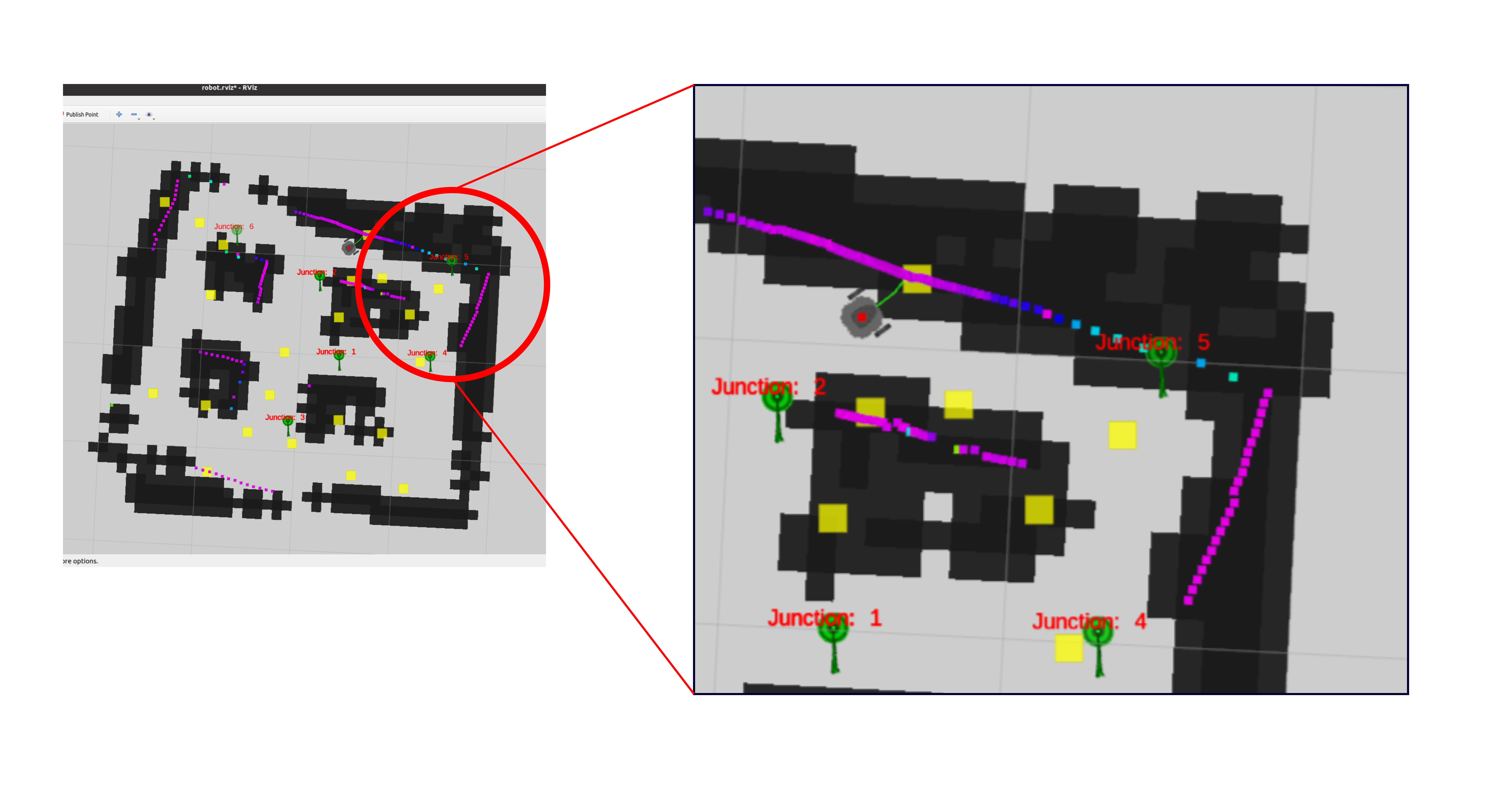

In lab testing and simulation, the RRT-based strategy which was identified to be the state-of-the-art approach demonstrated satisfactory results, especially in terms of speed. However, the information richness was compromised by the lack of detail in the created maps and the lack of data acquisition. There were certain shifts in the maps observed which can be seen in Fig. ref{fig: rrt_magnified}. Since the method performs well in exploration tasks, it is a good fit for applications where exploration speed is more important than map details.

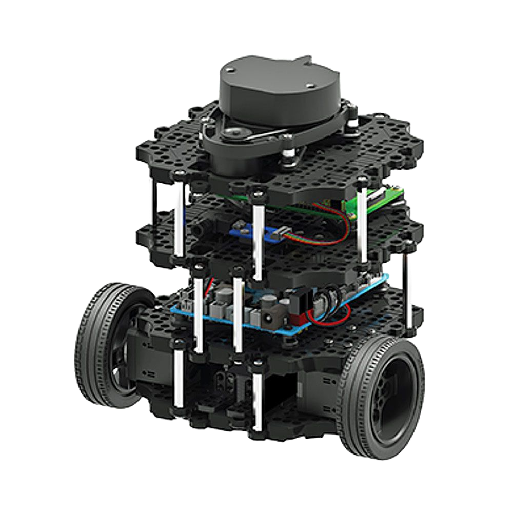

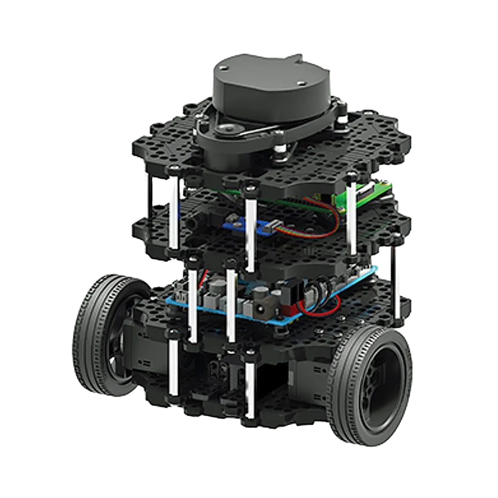

When talking about our proposed methodology the PDFS, it has some limitations such as, that when the robot is oriented correctly, the simulation testing of the robot shows great accuracy in junction identification. Its reliance on orientation, however, raises the risk of false positives in the event that the orientation is off. Compared to the RRT-based technique, the strategy’s exploration time is comparatively longer in small tunnel environments, producing maps that are precise and easy to understand. In a simulated setting, the method works well and consistently, however, in addition to the requirement of correct orientation, there were sometimes false positives detected due to lidar noise footnote{This issue only occurred with the Turtlebot3 due to it having a lower-end lidar}.
